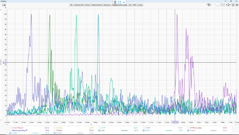

Hi
I measure my rear array of my DBA with “time reference” (Example) but I always get different impulse responses.
The measurements were made one after the other without changing anything.
Why is that?
the problem is when i work with the alignment tool it gives different results.
Which measurement is correct
thanks

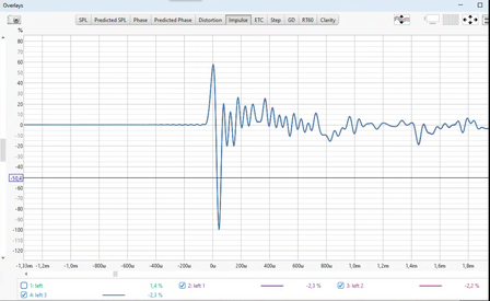

Pretty strange behaviours from the left speaker measurements, with odd distortion artefacts that may be a result of missing data. Try enabling the Analysis preference "Adjust clock with acoustic ref", that will make it easier to spot missing data since the clock adjustment would be strongly affected by that. Make sure the CX-A5100 isn't applying any surround mode processing.

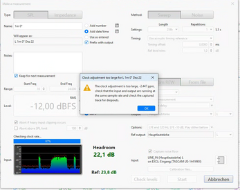

When i enable the Analysis preference "Adjust clock with acoustic ref" i get an error
new messages with the Analysis preference

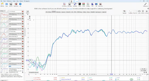

I have reactivated my old Mess laptop and now everything is working perfectly again. No error message, and the impulse response is always the same.
The Tascam works perfectly.
