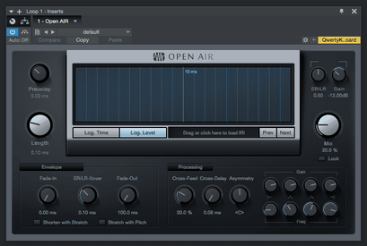

Is there a settings that produces the best results, some of these impulses plugins have various settings I’m not sure if a setting that makes the use more reliable like length, pre delay, crossfeed etc

Also I noticed that I need to have two files for stereo plugin on some of these types of plugins, I’m thinking I should make measurements of both speakers then maybe correct them individually to the target. I’m not sure if it’s best to use two mono signals for both left and right
7,403
I haven't used any convolution plugins so can't comment on how they should be configured. At low frequencies corrections should be individual to each speaker. If you apply corrections above a few hundred Hz they should probably be the same for each speaker.
