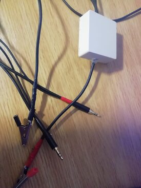

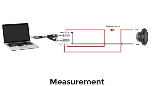

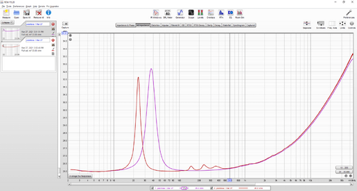

Hi, does anyone have a diagram or link, for cables with resistors, in the audio card, measuring with the amplifier, calculate the Thiele-Small parameters?
I made a cable directly in the audio card
sound blaster audigy fx pcie,with 100ohm resistor, but it doesn't measure well or I don't know how to set parameters :(

Hi, the impedance curve you attached seems to be correct, only the impedance values seem wrong.
Did you do the calibration procedure regarding the impedance?
The procedure involves three tests, open circuit with short circuit and with a resistance of known value.
After you have performed the tests the system will be calibrated.
Greetings
Antonio

yes I did,the calibration,with 33 ohm rezistor.
Feb 8, 2018
279
Italy
So the system is calibrated, did you re-measure the 33 ohm resistor after calibration?
You should have a graph with a straight line with a value at 33 ohms and phase at 0 degrees
If the result is as I told you, the system is functioning and calibrated.
Feb 8, 2018
279
Italy
One of the problems when using a low level signal output such as the line out of a sound card is that the speaker is driven with too little power and you risk getting it to work properly, and the system is sensitive to noise. environmental. It is always better to use a power amplifier to have an adequate signal level.
