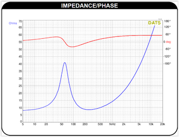

I have constantly different Fs measurement comparing with the speaker driver spec.

Please find attached files during one session of testing DA tcp 115/8.
Driver Fs by the spec is 59,2 Hz, by measuring I get 77 Hz.
