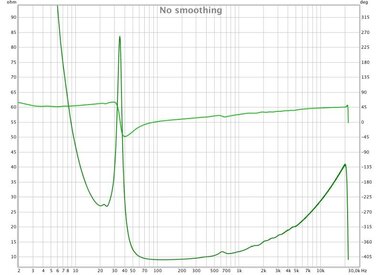

Hi, I´m new on REW so apologies in advance..
The image above is what I get measuring the impedance of a woofer: abnormal high values on low freq. The same happens with a fix resistor.. I use a BEHRINGER UCA 202 with a sharp roll off below 20 Hz nevertheless I have properly calibrated the audio interface so I assume that this would be compensated. Is correct my assumption?
Is the UCA 202 fit to be used with REW? if not which are the minimum requirements?
Rgds.
