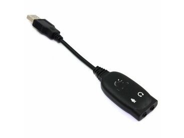

1. 4 prong audio out jack (Headphone and Mic combined)
2. USB to Audio converter (Headphone and Mic combined like a gaming headset)

I doubt that you can use the Surface Pro's combined connector, it doesn't appear to have a stereo input. The USB audio interface might be useable if the "mic" input offers a stereo line input, but you would likely be better off getting a basic USB soundcard.

To the audio input - I have tested that something with a 4 prong audio jack that the input and output (headphone and mic) are recognized by the system. (images attached above.)
Can you recommend a fairly inexpensive USB sound card - and would that make the rest of this easier?
