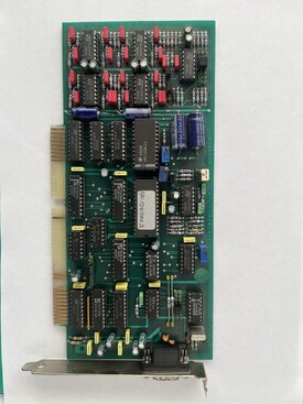

Thanks to everibody. Next weekend I’ll try…
I apologise but I’m new with REW.
I have an old CLIO but it’s impossible to install it on the last 20 years pc.
My CLIO was one of the first serie running on a AT Pc
Because of this Iwould like to learn to use REW that is an incredible instrument!
Marco
