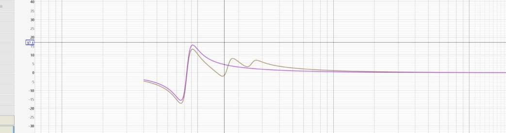

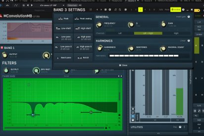

The problem with phase shift it give bad feeling in ear which increase when longer hear. also when stop hearing this strange feeling stay some time. hear longer time speaker with changed polarity. the longer you hear the more it sound worse. same is with phase problems too. but i notice a workaround.bass EQ with harmonic EQ. only melda plugins can do that. reduce room modes, such way give more nice phase and sound better. all is cumulative. if the speaker itself have worse phase and add eq make it even more worse and reach the level that brain dont like it. phase linear in bass have problems with transient
