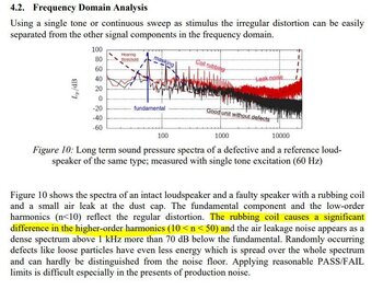

This software is very useful for helping me find Loudspeakers with Rub & Buzz, but I was wondering what it would take to get the higher order harmonics in the Distortion Panel (RTA).
Depending on the speaker, Rub & Buzz shows itself between N = 10 and N = 50 harmonics. Right now I just excite at about 300 Hz and then visually focus on the RTA plot from 10kHz to 20kHz.
Would it be possible to add a drop down to select the beginning and end harmonic value and then just have a single new Distortion value which sums the Harmonics between those two values?
