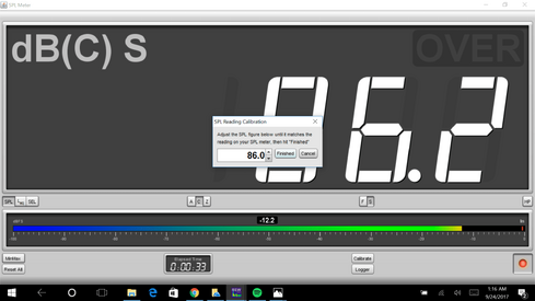

Then I click on the "SPL Meter" button and using an app on my iPhone I calibrate by changing the db level to match the level on my app:
Then I click "finished" and this pops up:
