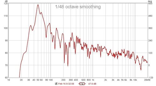

7,326
You have a very wide graph range (150 - 200 dB depending on the graph), so things look much flatter than they are. Use the Limits button at the top right of the graph to set a range of 60 dB - have a look at Matt's video for more on that:
Flat in-room responses do not exist, you may get flattish curves by applying a lot of smoothing or setting a very wide SPL range but every room has peaks and troughs, particularly in the low end. Here is your response with a 60 dB range and minimal smoothing (best for seeing what the low end is doing):
There is a very big peak at 50 Hz, which is probably mostly due to positioning of the sub and/or your listening position. The REW room simulator can help with getting an idea of how different positions will look if your room is rectangular. The sub is also well above the rest of the response so needs bringing more into line by reducing its level. Some gentle downward slope from low frequencies to high is normal for listening position measurements, but yours is more of a mountainside just now :)
