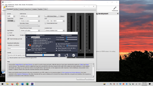

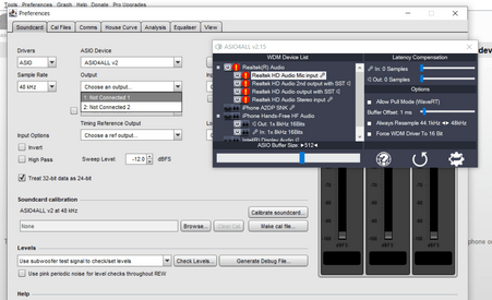

I have installed REW and ASIO4ALL, but I am having trouble with the WDM device list. Realtek is showing an orange exclamation point. I believe this is my problem and preventing me from moving forward. The guide that I am following is saying I should be seeing "High Definition Audio" 1-8 in the output. I have attached a screen shot of what I am seeing.
I have a 7.1.4 home theater that I am trying to measure/level match with UMIK-1. AVR is Denon X6200W. Dell laptop windows 10. REW V5.20.13/ASIO4ALL 2.15.

You should deselect Realtek, you aren't using it for measurement. The Intel display audio entry is likely to be the one you need for output.
Probably better off using FlexASIO though.

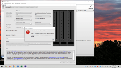

Thank you for the reply John! I tried using FlexASIO but I ran into this error message. Went back and tried Intel on ASIO4ALL and it isn't working either.

Did you choose MME in FlexASIO? If so you will have to pick devices from the first half of the list as an REW bug causes an extra set of entries to appear. DirectSound or WASAPI are probably better choices for FlexASIO.
