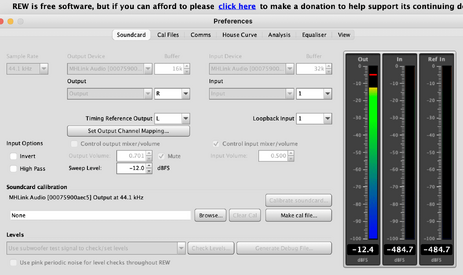

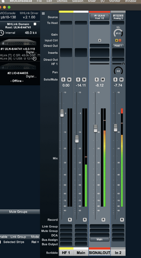

New REW user. I am able to send out the calibration signal, but can't get the input device to work.
I have input device set to MHlink and a mic input signal coming into the MH mixer, but can't figure out how to route that signal to REW
Any help would be appreciated!
D
Here are some pics - i'm sure it's a simple routing thing :flex:

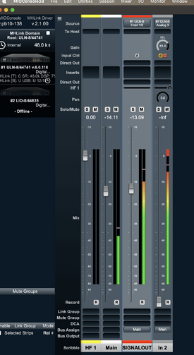

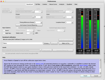

Think I figured it out
route Metric Halo mic input to Host 1
Change the REW input to DEFAULT AUDIO DEVICE
channel 1

It shouldn't matter whether you select Default device or the actual device which is the default. The -484.7 dBFS levels you were getting correspond to all zeroes on the input, that more commonly happens if REW hasn't been granted access to the mic. Good that you have it working in any case :)
