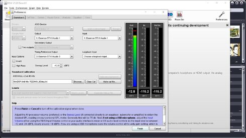

Hope someone can help me with the correct setup to allow me to measure my speakers (5.2 setup)
I have a miniDSP 2x4HD for bass management and are happy with the results attained using REW and a Unik 1 mic
I would now like to check the other 5 channels and are having issues setting the correct settings
My setup -
Marantz AV7005 Receiver
Marantz MM7055 Amp
P.C running latest version of Windows 10 64 bit with Latest version of Java, Version 5.20 beta 61 of REW

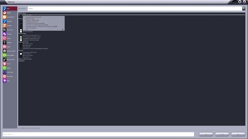

And I use Jriver 27 to playback all my content.
The P.C has a Asus STX Essence 7.1 sound card with in connected via Coaxial and Analog.
They are currently both setup and working as expected. (I have Analog set as default)
The ASUS windows 10 drivers are installed along with ASIO4ALL
I have attached screen shots of how the Windows Sound Control Panel, Jriver and REW are configured
Can you please point me in the right direction with suitable instructions on the correct setup to complete sweeps on my 5 speakers separately.

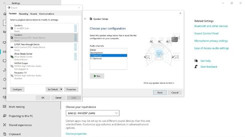

Do you have an option in your Sound Control panel under Configure that allows you to choose 5.1 or 7.1?
I'm not on my REW computer, but it would be listed here...
41590
The next question would be is the soundcard surround capable?

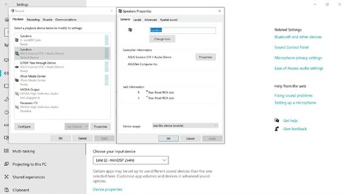

Yes I do have that option in the sound control panel to set as 5.1
I have just run the test and all speakers are working (see attachment)
Soundcard is Asus Essence STX 11 with daughter board and is surround sound capable
I have a Coaxial output and Analog outputs both connected to my receiver. I switch via the receiver
Depending on what I am using. Coaxial for movies and Analog for Audio

Hopefully FlexASIO will fix it for you. Opening Preferences in REW and selecting the Flex Control Panel, select your soundcard and mic... load it... and you should be able to select the other speakers in your system then.
Yes, that has worked and I was able complete sweeps of each speaker and create filters
