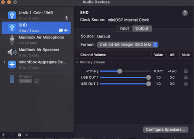

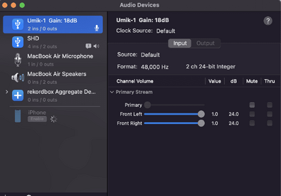

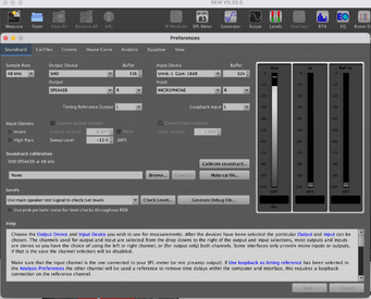

Well shoot, same issue persists. Not sure what I changed, as I recently had REW working correctly, but here are screen shots of my preferences in REW and Midi. Thanks in advance for taking a look!

That just means notifications are being routed through the SHD. Suddenly everything is working again. No idea what I did, but I don't think this is an REW issue. Thanks for your response!
