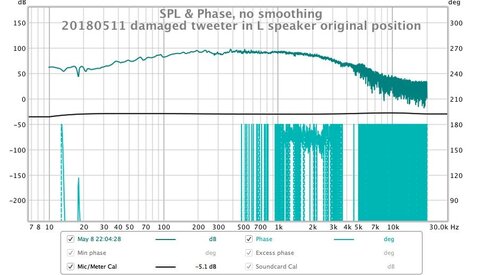

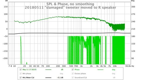

I'm afraid you can't EQ away distortion. From your close mic measurement the left tweeter doesn't appear to be working now. Swap over the connections between left and right to make sure the problem is in the speaker rather than somewhere else, and check the tweeter wiring, but after that replacement is likely the only option.
John,
I moved the suspected damaged tweeter from the original position in left speaker to the R speaker and measured again with mic 6" from tweeter. Sure seems to me I am going to have to replace this tweeter. Which is what you suspected. I have uploaded the files for your review and comment.
My 104/2 tweeter is model is TS1191 which are longer available as far as I can determine. Probably go with a pair of Morel MDT29 for now. Cheers
7,326
Pretty big SPL range in those plots, but does look like the problem is following the tweeter.

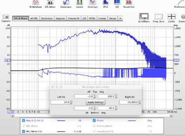

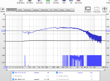

Ok thanks. I believe you told me to adjust spl range to use the limit button. I made a screenshot showing my attempt. Have I got it right. Also, what might typical values be for dB top & bottom. Thanks so much for the support.
7,326
That right hand side is the axis for phase in degrees, it is the left hand side that needs adjusting - try 105 dB at the top and 45 dB at the bottom.

Think I got it now. Take care

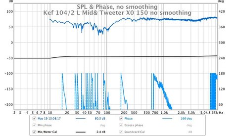

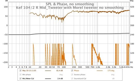

Hi John,
Attached are measurements of my Kef 104/2 with both tweeters replaced with Morel MDT 29. Looks like I have working tweeters and need to EQ to smooth out the curve a bit. Will continue following your work. Take care
