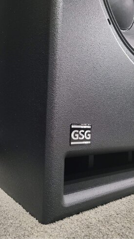

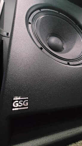

Working on the new Dual 18 and 21 cabinets this weekend (prototype, test fit, confirm tune, etc). We're also making some progress on the new Vented/Sealed 24" cabs. While we're working on that I wanted to share a few social media posts/screenshots.

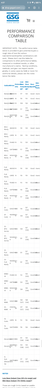

I don't see these listed on the website. What is the cost? Comparison to the other products.
When might you have the evolution series (dual sub). In the comparison table?

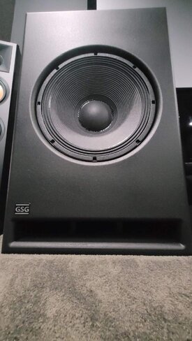

New for 2023!
Evo Sealed 24"
, 28.55” wide, 24.0” deep, 36.34” tall & >110dB @
16 Hz
Evo Sealed Slim 21", 26.6” wide, 17.0” deep, 34.3” tall & >112dB @
20 Hz & >125dB @ 70Hz
