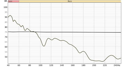

I have a 5,2 setup in my living room. I use a mini dsp 2x4 hd for the LFE signaal from my Arcam air 390
The speakers are the DALi 2x Options 6, 1x vocal, 2x optical 1, Dali EF 12 and Dali EF 9

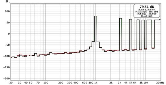

I have try to measure the RT60 , have made a WAF file in the generator /tones/square and I have loaded that WAF file in to RTA.
is this the right way to do it?

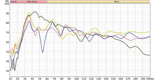

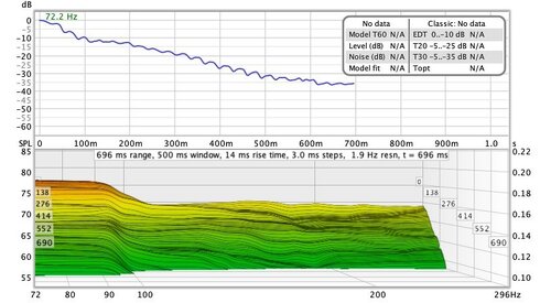

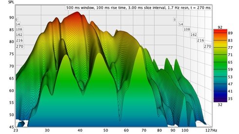

I hope I did it right, What do I see here and is any good? It is in my living room.

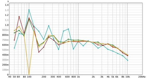

Looks OK, would be easier to tell from an mdat file. Quite long decay times, is it a very large room?
it is a room 10 m long, 5 m deep and 2,60 m high with long glas window and some corners.
