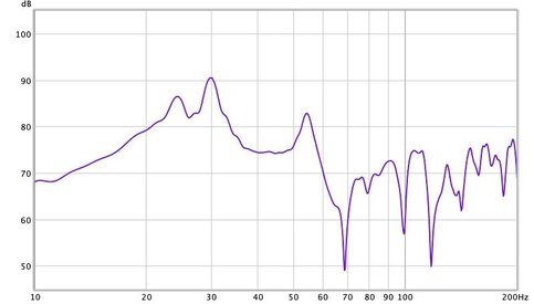

I THINK I did my first attempt at REW more or less correct...I am using a UMIK1 and REW. Speakers are B&W 802D3 with Devialet D Premier. No subwoofer.
Did a full range sweep from 15Hz.
Am I correct in interpreting the graph as follows:
1. Humps/Peaks at 25,30 and 55Hz.
2. Troughs/Nulls at 68,99 and 120Hz
I'd really appreciate some input on this graph...
I am a beginner :)
Thank you.

Yes, that's right. Those notches may move or disappear if you change the position of the mic or sub.
Thanks for confirming John. No subwoofer in use (at the moment), just a lot of testing, listening and making small changes to layout and retesting. Thank you.
