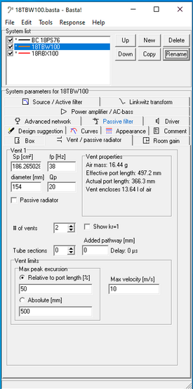

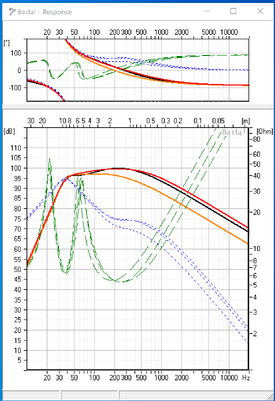

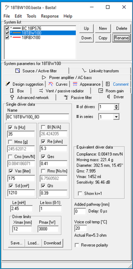

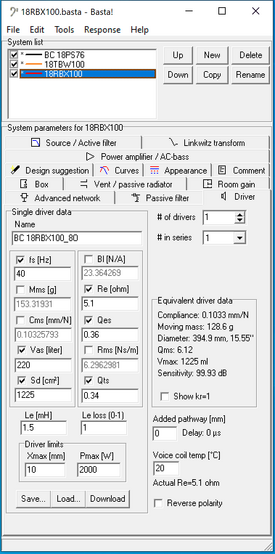

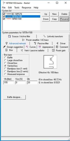

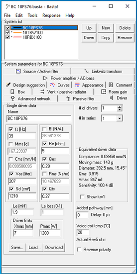

Hi. So I tried doing some simulations myself using Basta!. Would you be able to help me understand why is there such big difference between our graphs? For me it shows that the best option is an RBX100 with a very close call from the PS76, while the TBW is really underperformig.
Driver Specs:
Box Vents Response

I am not familiar with your simulating software. I have simulated the RBX vs TBW and both will get you the same spl at tuning if using only 650watts roughly. BUT the TBW is not at Xmax yet. The RBX also would like a larger box for that tuning. Even in your simulation the RBX is falling off in response shape before the port tuning, where as the PS76 and TBW100 do not.
The TBW100 needs about 1000watts to hit Xmax. Again teh TBW in Black and the RBX in gray. The RBX as a lower Le which is why it extends higher in the response but the higher Bl and lower Vas of the TBW allows for the speaker to behave better in a smaller box for the tuning.
