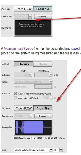

I can't find what should do next :) I made sweep file. Then I saved it in wav. What should I do next? I can't find this (in attach)
Open the Measure dialog
Press the From file button
Load the sweep file in REW so it knows the file settings, either using the Browse button or dragging and dropping it onto the window that says "Drag the sweep file here or use the Browse button"
Press the Start button
Play the sweep file on your player

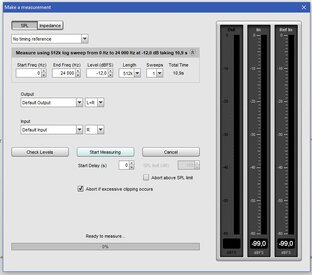

Where is this button?
When you said "Of course I have latest version" I guess you didn't bother following the link I posted to the latest version?
Ahhh, crap, sorry!!! Downloaded another link, my mistake. Will download right and try again......See it only now.
Thanks for your patience, John. Everything fell into place when I downloaded latest version.
