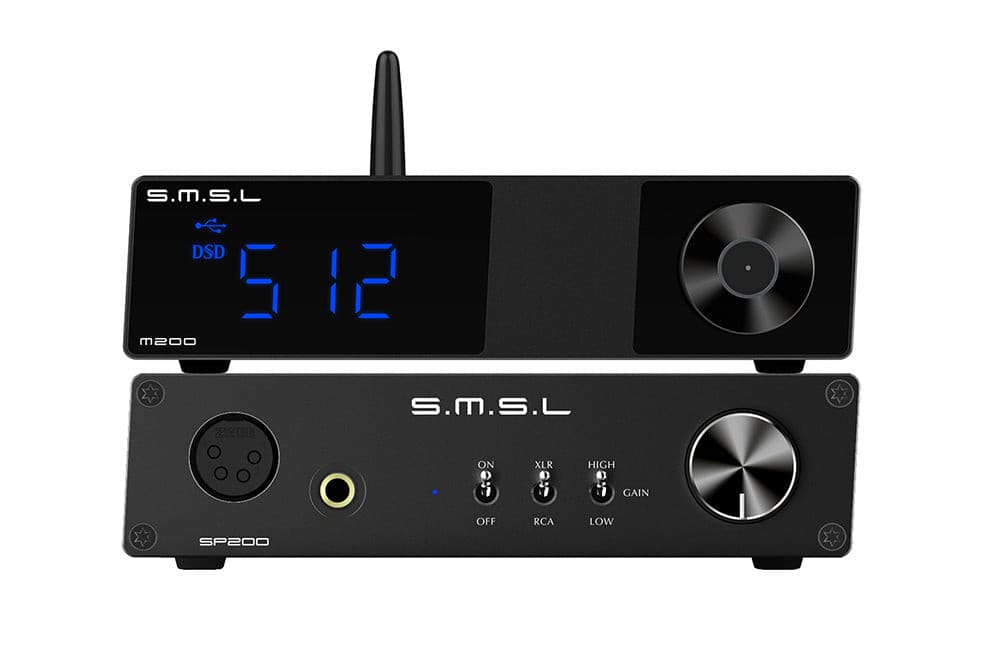

in conjunction with a DAC such as this one
or similar.
