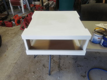

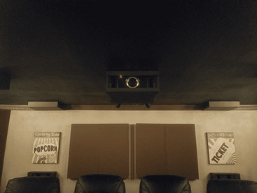

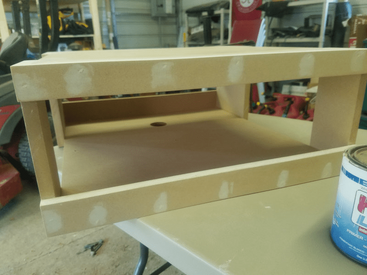

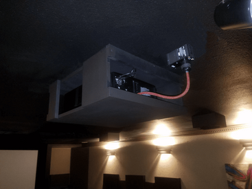

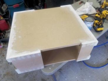

After getting my JVC DLA-RS620 in and ready to install, I learned that the projector mount that holds my Panasonic 8000 would not work on the JVC. Instead of ordering another one, I got to thinking why not just build a ceiling shelf. The ceiling in our room was originally 1/2" sheetrock and when I built the room I added 3/4" plywood and another sheet of 5/8" sheetrock. So... there is plenty enough solid to attach a shelf that will hold up well.
I had some leftover 3/4" MDF from when I built and installed the MartinLogan EM-IC's in the ceiling for Atmos. It was a fairly simple task that ended up taking a couple of days to finish in between doing fifty-eleven other things.

I like the way you think Sonnie! Do you notice any heat build up or is there plenty of air circulation? I would imagine that design completely eliminates vibration.
I made sure there was plenty of ventilation all around the unit... no vents covered.
My guess would be less vibration, but I don't really know. The ceiling is coupled to a fairly large beam across the room for structural support, given the load of the ceiling with 3/4" plywood and 1-1/8" sheetrock... green glue, screws, paint, etc.
Fire up one of those movies with heavy bass & we'll know for sure. I can't imagine that box will vibrate, but the PJ might (doubt that also) unless it is mechanically attached.
