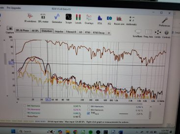

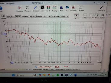

Hi, I've been trying several house curves with my Integra AVR and Dirac live, but I’m still not happy. The bass is kind of muddy. At times, I feel like my ears get tired and I don't even listen too loud (around 60db dialogue). I measured L+R (see below). One thing that may be high is the distortion for 2nd and 3rd harmonics and THD between 20db and 30db, and around 41 db. Do you think that's what causes my ears hurt? Is there anything else I should check?
I used 1/6th smoothing.
Thanks.
