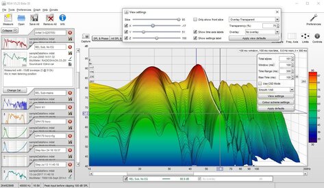

Hi John,
What do you think about a kind of detachable "graph control" panel, especially in the "All SPL & Impedance" graph?
when trying to overlap the tracks, if these are towards the top of the graph it is difficult to see them because they are covered by controls, so a detachable control panel could be moved elsewhere.
Thank you.
regards.
Oliver.
As it happens I have been changing some of the more crowded controls panels to use separate dialogs, starting with the View and Colour scheme settings for the waterfall. I'll work my way through the various panels.
