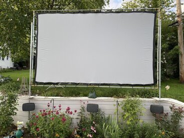

My pandemic project was building a 7.1 patio theater - my wife loves movies. This was all very budget conscious but I tried my best to make good decisions and exploit inverse square law and boundary gain when it came to the subwoofer.
When I first set it up I used Audyssey - included with Denon AVR-X1600H receiver - to set levels and phase, though it was not something I'd want to do again since Audyssey was not meant to be used outdoor. I imagine the neighbors were not happy with all the noise and volume levels required. I have never bothered to measure the system after it was done, until today.
