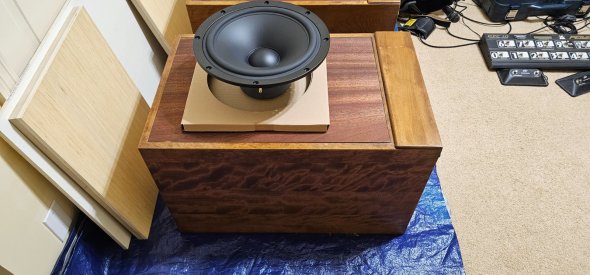

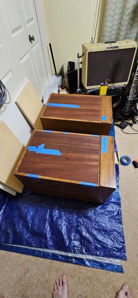

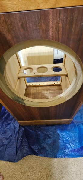

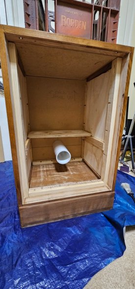

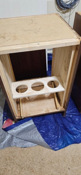

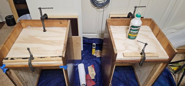

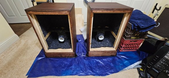

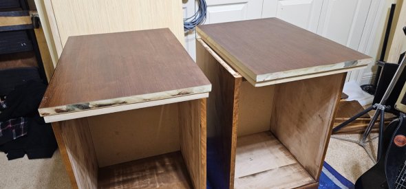

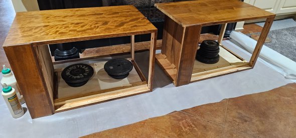

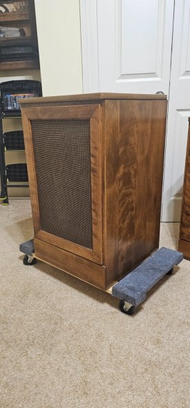

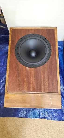

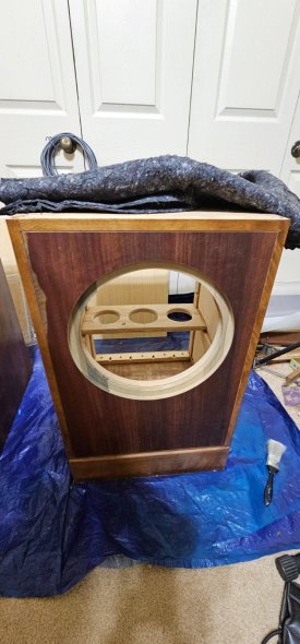

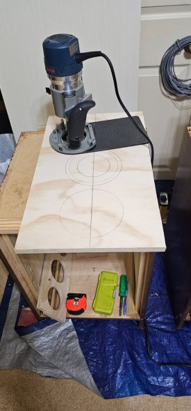

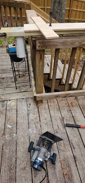

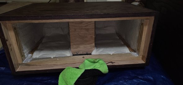

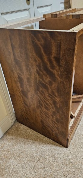

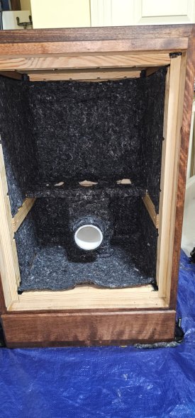

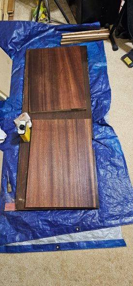

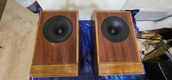

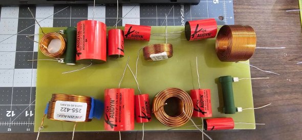

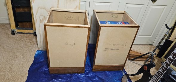

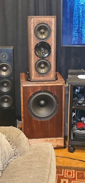

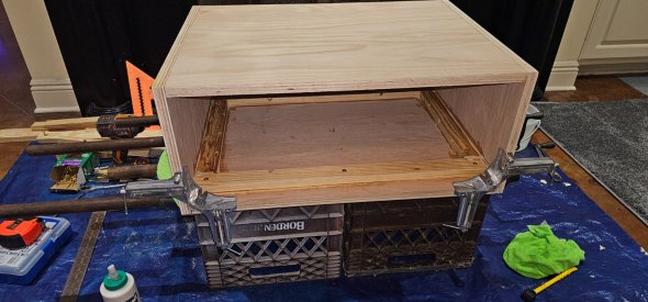

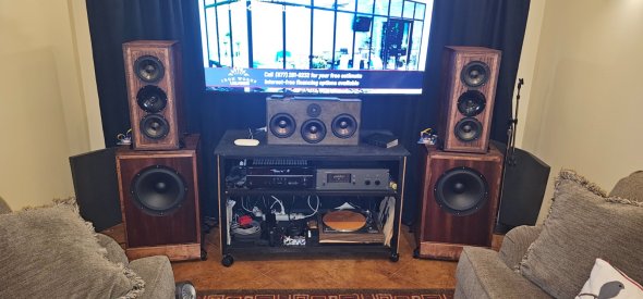

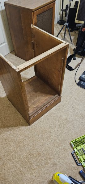

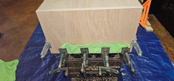

These are what I built and measured. They sound amazing. A lot of time and effort went into these. Multi material internal dampening. Very balanced physical load to the Woofer. LR4 Crossovers using quality components. These speakers completely changed my Theater experience. They get very loud while being very clean and the room excitation is very low I would say a calm loud room if that makes sense. I took most of the absorptive wall materials down because it was no longer needed. These are a waveguide of my own design that started from 2 other sources but I then modified it. Instead of fully loading the tweeter I backed off for a less physical loading approach that has paid off bigly. The waveguides are loaded with Morel CAT308s but I remove the 308 faceplate and mount directly to the waveguide. The woofers are SB17CRC35-8. The crossover is LR4 2 Way. The enclosures are ported and tuned to around 40hz. I literally have 1 single room mode filter set in AVR EQ. I have the subs active DSP but honestly these waveguided MTM mains do not even need a subwoofer because they hit hard and low. The whole enclosure story is a trip. Those sub enclosures are made from 195* something Jensen speaker enclosures and a 1954 piano for the baffle. I used CLD in both enclosures, The enclosures are screwed, glued, and precise in fitting. I used 5mmeva foam and appliance blanket materials for the dampening so there are many values of multi band dampening, which also paid off in a very quiet box. I wanted these Jensne boxes and this old piano donor material to make music again like it had for many many decades so now they live on making more music and joy.

I do not have as many Xovr pics but I used quality everywhere.
