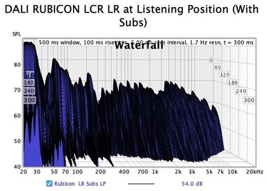

Thanks for the rewiew.
Can you put measurements to see the acoustics of the room ?.
It is simple curiosity to see the TR, Waterfall, ETC
Written with Google translate
Greetings
Greetings

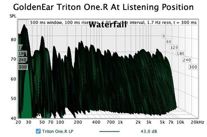

Attached is the waterfall for the DALI speakers and my reference speakers in the same room.
Other than what you see at the link above I do not. If you have any specific questions I would be glad to answer as best I can.

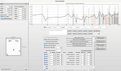

From my perspective, it is a fairly large room 18.5' x 21.5' x 9.5' with a few niches/cavities around the sides. Although not laid out to the "Golden" acoustical dimensions because of its size it is rather forgiving acoustically. The exception to that is, of course, for the bass nodes that are generated by the room. I get around much of that with multiple subwoofers. Currently, I am running 2 Rythmik F18 subs (18" 900 watts RMS) at the 1/4 and 3/4 marks on the front wall and 2 Diversified Technology PF 15's for fill, left rear corner and right side wall about 2/3 distance from the front wall. In addition, my normal reference speakers contain subwoofers and are run full range. These locations were modeled in REW Room Sim and then vetted through a "subwoofer crawl" and just plain ol' listening.
Distance between the front left and right was pretty much dictated by the width of my screen. Ideally, they would be a bit closer together but I have enough depth in the room to still set them up in an equilateral triangle configuration with only a mild toe-in.
Acoustical treatments were used to tame a barely noticeable flutter echo. The room contains four 2' x 4' x 2" diffusor/absorbers by GIK Acoustics on the screen wall and sidewalls flanking the main right/left speakers. There is a 1' x 4' x 4" diffusor/absorber/ bass trap on the screen wall directly behind the center channel. Three more of the 1' x 4' x 4" diffusor/absorber/ bass traps are on the back wall.
The floor is carpet with extra heavy padding. The sidewalls have irregular surfaces to break up the sound. The room would probably benefit from a few additional panels on the sidewalls/back wall, and possibly bass traps in the four corners. But that is a project for another day :cool:
I will get together some REW or Fuzz Measure measurements when I finish the current review project and get back to my reference setup :-)
Thanks for your interest! Let me know if you have anything specific that I may have missed!
