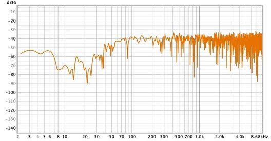

I am planning on treating my 3.6m x 4.6m x 2.6m (height) room and I just had a go at analyzing my room acoustics with REW.
here is the graph and unfortunately I only have sm57 dynamic mic so, I just gave it a go.
Could you see big issues that I need to be aware of?!

Change your graph scale (using the limits button top right of the graph) so it goes from 30 dB at the bottom to 90 dB at the top. Attach the mdat file for the measurement (you may need to wait a little while or make further posts to add attachments).

Thank you, sorry for providing with limited information and not-so-helpful graph. I will again, provide better images. (Please bear in mind, this is my very first time trying to measure my room acoustic with budget studio monitors (freq. response: 80-10kHz).
I will update real soon.
Thank you so much for your kind reply.

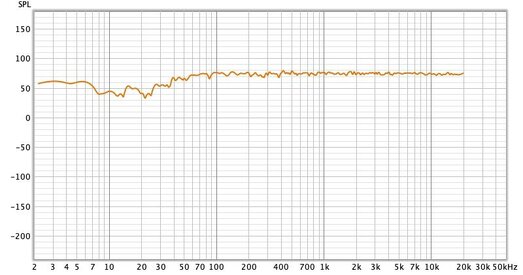

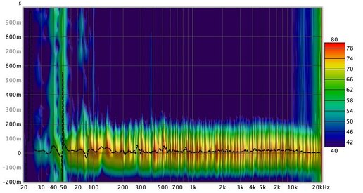

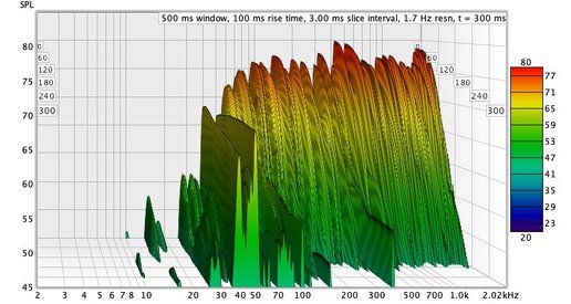

I reopened my rough measurement record and zoomed in for better analysis. Changed Y axis to dBFS so I understand better. but I think my room has many issues. How shall I attack this? thanks!
I am planning to purchase treatments for first reflections and also dense bass traps, also DSP monitor speakers (so it can adjust after measuring).
What would you say, the biggest problem of my room? How would you resolve to get the most out of it? I guess, my room, to start with, can never be perfected.. since it is a fairly small room... (4.23m x 3.6m x 2.4m)
The more I study, the more stress haha
thanks!

Have you eliminated environmental noise pollution as the possible source of these ( ultra ) strong resonances seen at @ 40 + 50 hz ??
- Simply open the RTA window with a test mic but no test signal and look at the room noise curve ( using max resolution > such as 1/48th smoothing )
What-ever the source of those two strong modes >> you won't be able to deal with them yourself ( excepting by paying professionals to deal with them >> mere home-built Bass control corner chunks won't come close to dealing with that much excess energy ).

As it is 50,100 and 400 Hz narrow peaks, i bet those have not an acoustic but an electric origin, your system picks up hum somewhere.

Ah.. ok! actually my test was not legit cause I did it with sm57 dynamic mic. I am getting proper tester with proper omni mic. I guess it is really really difficult to treat in my small home studio room... Do you think it would be smarter to invest on sonarworks OR DSP powered smart studio monitors 'and' a decent reference headphone...? because, I cannot perfect this anyway by treating right...? What would be a smart way to win some and lose some...?I am not so sure about those strong resonances around 40~50 Hz.... to be honest........ slightly shocked... is it normal...?

Ah.. oki! I tested with my eris 3.5 3inch small monitor speakers and sm57 <--- so... this test will not do much justice I think... I am getting my main monitors soon and also that monitors have testing kit called GLM.
9,264
Could be something in your home - HVAC system, for example. As suggested above, use the RTA feature in REW and see if you can capture it without your seystem engaged.
