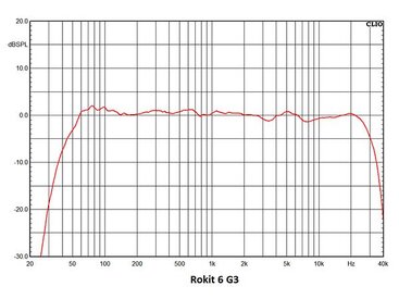

My speakers have this from the manufacturer. Is it possible to override this or maybe I have to do this manually
