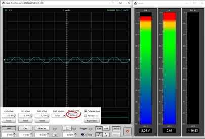

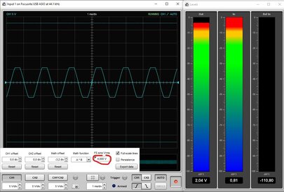

John,
I note a malfunction or a misunderstanding on my part concerning Full scale line in scope mode.
The definition of Full scale lines is (REW documentation) : If Full scale lines is selected dotted lines will be drawn at the voltages corresponding to positive and negative full scale for each input channel.
The behavior of the lines does not seem to follow this rule when "FS sine Rms" (input sensitivity) is different from 1.
Example with my sound card (asio driver): when « FS sine Vrms » (input sensitivity) is 1, it is correct but when « Fs sine Vrms » is different from 1, the lines do not correspond to FS.
Eric
