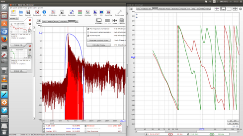

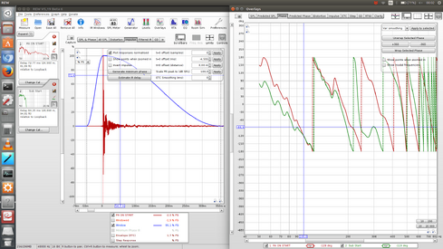

But i found bug: If I offset IR on Impulse window, on Overlays->Phase I see correctly phase shift, but on Predicted Phase window I doesn't see phase shift. When I open EQ Filter and toggle some filter ON-OFF-ON, predicted phase is updated.
And one more: when I open main window and overlays window, i can't insert phase shift, so I doesn't see control panel. In early versions this been OK. This windows layout is very nice for time alignment.

Thanks for the reports both, I'll track down whatever has gone on with the control panel position. On the netbook in the meantime using the Collapse button above the measurement panels will provide enough space for the graph and controls to display properly (perhaps also using the button to turn off the scroll bars, the graph can be moved by right clicking on it).
7,361
I've made a couple of changes to help with the formatting. I shaved 50 pixels or so from the waterfall controls panel width (which is the underlying cause of the problem) and I've also altered the way the panel is contained within the graph so that it will move across all the way to the left edge of the graph before it starts to get truncated at the right edge. Those changes will be in the next beta. I'll look at the predicted phase update issue next.

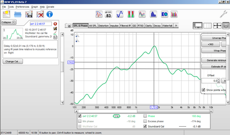

but there is an opportunity to increase the working field by hiding the toolbar?

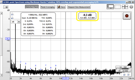

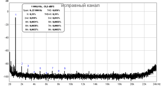

Another question: is it possible to keep the level of the first harmonic on the graph?
