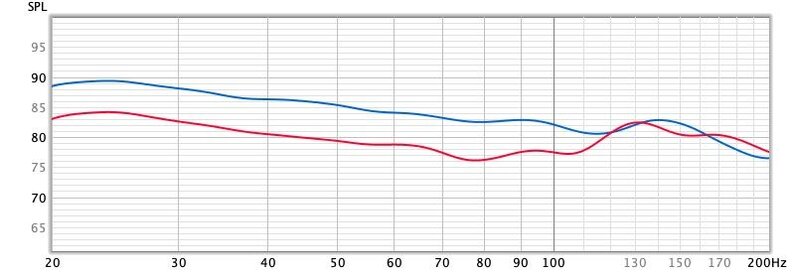

I was running sweeps of my fronts+sub and centre+sub both XO at 120hz
I noticed the 15-120hz range was the same shape curve in both (as expected) but the centre channel was 5db lower.
Beyond 120hz the levels match out to 15Khz
I then checked the surrounds and they are also 5db lower than fronts in the bass range.
Its a Yamaha AVR and I wondered if this is normal?
If not, am I losing something from my sound?
7,344
If you send signals to both left and right bass limited speakers there will be bass redirection from each to the sub output, so the sub level would be 6 dB higher than if you measure with a test signal going to one channel, such as the centre or either front speaker on its own.
