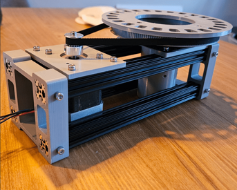

The table (made from the Audiomatica Medusa project files)

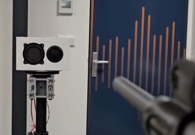

Table in action

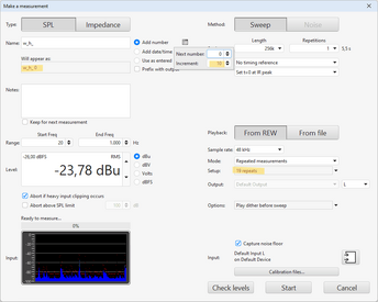

It uses the measurement 'Increment' number as rotational distance input for the turntable.
The 'Repeated measurement' feature in REW allows for automated repeat.

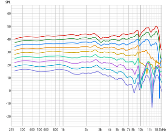

Example of 0 - 80 degrees measurement sequence (gated)

I didn't see printable files for the Audiomatica Medusa parts. Is this an Audiomatica members only thing? Not difficult to reproduce/improve in 3d but who doesn't like the easy button?

You have to subscribe (for free) on the medusa project page to download the files.
It is a great little project and thought it would be nice to have it integrated with REW.
I used a single motor driver and with an Arduino Nano, instead of a full CNC-shield. I thought the Gbrl-firmware to be too cumbersome for a simple rotation operation, so I wrote my own Arduino program that listens to serial commands.

That is the Peerless TC7FD00-04 in a prototype. The project is a miniature three-way with listening window optimised performance.
Poster preview:
I was actually surprised by it's raw response.
