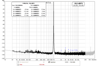

I uninstalled beta REW5.20 (using IObit unnistaller) and made new instalation REW5.19.11 (previously working perfect with ASIO driver ,with 24bit resolution),it is visible at attached picture, card loopback... Now is all working OK again, till I try to open RTA window.. This do not appear and program is not responding .After a while i try to open Measure window, now it is not responding (worked correctly before I tried to open RTA windov..). After closing program and restart, all again as described..But it is simply impossible to open RTA window and to make spectral measurements.
Before I tried beta 5.20.2, everything was OK.. Here must persist some "footprints" about previous installations, becasue in menu Help/About REW is number of previous measurements visible... And the same version (5.19.11) worked correctly before first reinstalling beta 5.20.2. Other programs (e.g. ARTA, SpectraPlus, Holmimpulse are working correct with the same card and ASIO driver. Any ideas how to repare this? REW_dBc.png
