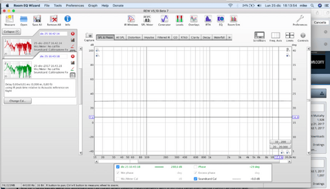

Hi John
a question: REW 5.19 beta 7 when you do a sweep in the SPL & Phase window nothing is shown, why?
(mac high sierra sound card focusrite scarlett 2i2)
thank you
7,324
If you look in the trace legend you will see the level is 288 dB, you have a level calibration problem which can be corrected for new measurements by redoing SPL calibration on the SPL meter, making sure to enter the reading from your own meter (not the REW meter). For those measurements you can add an offset to shift them down using the graph controls, -200 dB, for example.
