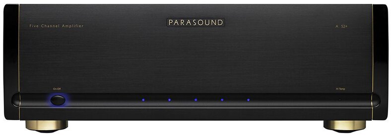

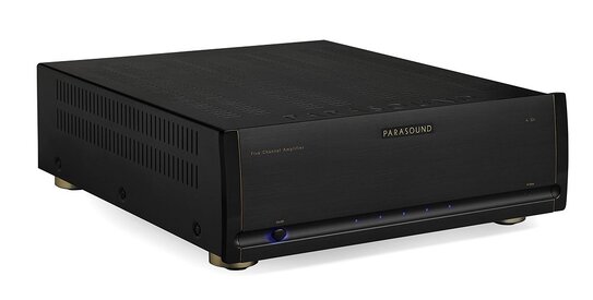

The Halo A52+ (five Channel)is a brand new model that is a lower wattage that sets just below the still current big five channel amp, the Halo A51 (the A52+, features 180 watts into 8 ohms per channel vs 250 watts per channel into 8 ohms on the A51). While this was a drop in power from my old NC 5250 I had judged this to be fine for the center and surround channels in my system with the gains in the sound QUALITY expected (hoped for).

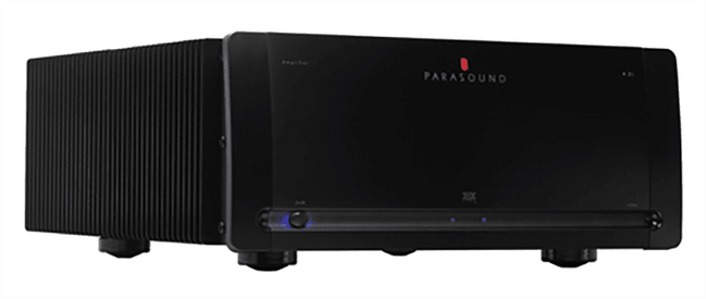

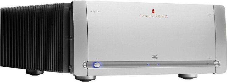

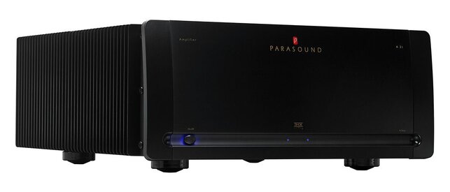

The Parasound Halo line is available in both black or a very nice silver finish (with the exception of the BLACK ONLY A52+). I went with the black finish on the A21 as it fit in with everything else in my rack. I have seen plenty of the Halo in silver and I do admit that it is quite elegant and even beautiful. If in a music listening only environment I very well might have opted for the silver finish :-) The A52+ is the one Halo Model that is available ONLY in black.
Black Vs. Silver Finishes
Grunting, I pulled the A21 from the box (60lbs) and looked it over… The fit and finish were perfect…flawless. The curved aluminum front panel is imposing, but elegant and tasteful with only one button. The small backlite on-off button, two channel status LEDs, an over temperature LED, and a backlit Parasound logo top center are the only breaks in the front panel making it sleek and elegant.

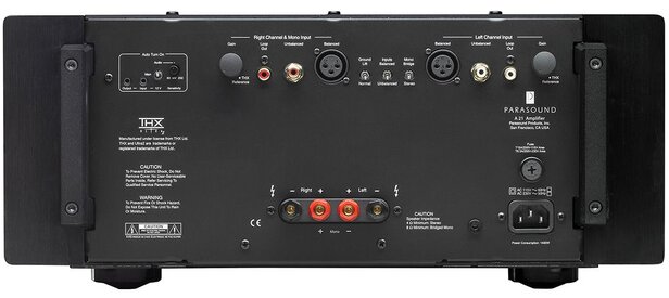

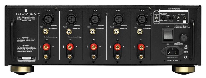

The back panels of the amps are all business as well. Both amps feature Balanced (XLR) and unbalanced (RCA) inputs with a selection switch to optimize signal level for either.
Power on/off management in the form of three selections:
1. Manual – Using the front panel switch to turn the unit on and off
2. Auto Turn On – Amp will auto turn on or off with signal to the inputs (or lack of signal). There is a threshold adjustment for this option.
3. 12V Trigger – Trigger in and loop out for daisy-chaining triggers to other devices.
Three-Way Heavy-Duty Binding post for all speaker connections.
The A21 also features a Ground Lift switch and Level Controls and unbalanced Loop Out for both channels (missing from the A52+).
The A52+ has a master power switch on the rear panel not present on the A21. Both units are fused (power supply) on the rear panel as well.

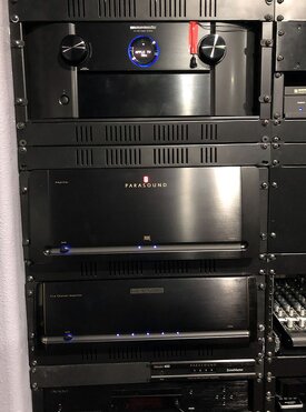

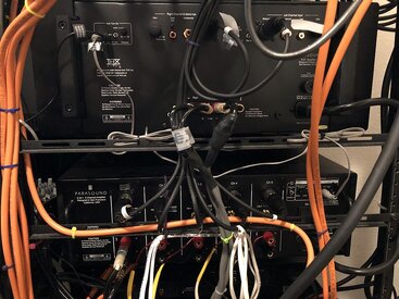

I had a plan (I usually do…for better or worse :-) for mounting and connecting the amp. I would first remove the isolation feet included and set the amp on a “test platform” before attempting to rack mount it. My “test platform” consisted of an inverted 3U rack shelf installed in my rack about chest height (just below the area where the 3U NC 2250 was installed previous). This shelf provides enough depth and support to comfortably hold any amp and provide a stable platform for attaching the amp by the rack ears later... Note: If you are using the inverted shelf method be sure to cover the metal shelf with a cloth that can slide with the amp and prevent any direct contact to the bottom of the amp to prevent scratching the finish.
This amp is heavy at 60 lbs., so if you don’t have much upper body strength, and I don’t particularly, please note this should be a two person job. Not necessarily veryheavy, but still, a large awkward piece. As I had, on occasion, moved my old amps including the slightly heavier NC5250 in and out of the rack without issue I felt superman enough that I thought I would just toss it up into its niche. So, I took a stab at it only to fail on the first try! I got it up there OK but it didn’t seem to fit my 19” rack. I set it back on the floor and measured the top of the amp and the rack opening to find that with this amp the clearance was only about 1/8” on each side of the protruding heatsinks! I boosted it back up and made sure that it was aligned perfectly and it slid right in…. Whew! Both amps do have sturdy handles on the BACK PANEL OF THE AMP to help with muscling it around and that certainly helps!
Once the Amp was safely resting on my “test platform” I connected the speakers, inputs and AC power (supplied power cord is a 14/3 standard IEC grounded power cable) and fired it up. The first indication that is was “live” was the soft blue glow around the front panel power switch increased in intensity (from the amp standby lighting level) , the two channel status indicator LEDs lit in a soft blue, and the Parasound logo softly lit in red. Very classy and of sufficiently low intensity that it should not be an issue even in fully darkened rooms if your rack happens to be near the screen as mine is.
Background was dead silent with no input. I played a bit from a random disk and there was sound so I turned off the amp and moved on to actually rack mounting the A21. I usually isolate my equipment when rack mounting with rubber grommets and spacers or use a product called HumFrees to minimize the possibility of “rack hash” and ground loops and did the same with this install. In this case I used the HumFrees Rack Isolation Tabs and mounting went fine. When secured I removed the inverted shelf that I was using for support and proceeded to the install and quick test of the 3U A52+.
Unpacking the five channel Halo A52+ went much the same way and as the A21 with the same “fit and finish” impressions logged. There are very minor exceptions/differences with the cosmetics of the A52+. There is no backlite logo and the “creases” in the front panel are highlighted with a subtle red piping. Still very classy…
The Halo A52+ was installed with the same inverted shelf style “test platform” as I used with the Halo A21. I connected the center channel and side and rear surrounds and performed the same quick test as before (sound = working). I then proceeded to rack mount the A52+. Same Isolation technique using the HumFrees tabs was used.
I use the 12V triggering to turn my Amps on and off. I did try both the manual and the Auto On and those options work as the should on both amps
Upon turn on I noticed a bit of what I call “rack hash” on the center channel and surrounds. “Rack Hash” as I define it is a bit of 60Hz hum mixed with a higher frequency “Buzz” and a little even higher frequency “garbage”. I traced the noise back to two the two Yung subwoofer plate amps that I am using on my Earthquake Q10B Tactile Transducers. The Yung’s were meant as a quick fix when my Earthquake XJ-600 amplifier went belly-up but they worked well enough that I left them in the rack in lieu of repairing the much more expensive XJ-600 amp. The noise was low level and disappeared completely when I disconnected the inputs to the Yung amps, so that is exactly what I did, saving the Yung problem for another day.
Equipment and Cabling Used for Evaluation
