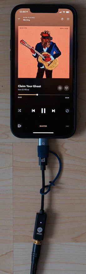

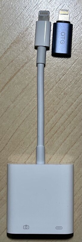

BOLT ships with Android, iOS, macOS, and Windows 10 compatibility, allowing for plug-and-play use with computers and smartphones offering USB-A or USB-C connectivity. If you intend to use BOLT with an iPhone, you'll need Apple's Lightning to USB Camera Adapter and the included USB-A adapter. Apple's camera adapter will set you back roughly $30 and adds some extra bulk to the arrangement, stretching its overall length to 9.25", which is a consideration if you're looking to pair BOLT with an iPhone for tunes on the go.

BOLT's biggest drawback is its inability to connect directly to an iPhone. While the incorporation of Apple's USB camera adapter is inconvenient, it's not a deal-breaker. Yes, it adds physical length to the arrangement, but it's more than manageable for desktop duty and isn't too cumbersome when a phone is carried in a back pocket.
