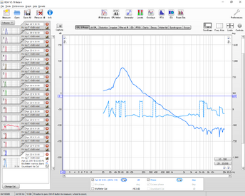

I made some measurements this morning with 5.14. Then updated to 5.19 Beta. Files look OK in <Open> dialog, but read incorrectly. Reading again gives different results (look at #4 and #12, same measurement). Then I backed down to the current release 5.18. Same result.
OK. Backed to 5.14, and everything is working again.

Thanks Marc. The files are OK, it is a side effect of some RT60 calculations being done when the file is loaded - one of the octave band filters is left applied. It can be fixed by going to the FilteredIR graph and setting the filter to none (bottom left corner of the graph). I'll look to get a fix in the next beta.
