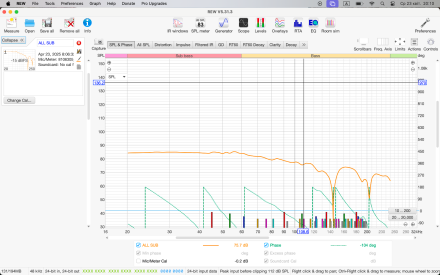

I’d like to ask if anyone has done something similar, or if someone could give me some advice — whether there’s a way to improve what I’ve done, or if it’s already good as it is.

Using three MiniDSP 2x4 HD units, I grouped them into three “super-subwoofers”.
To connect and align all the subwoofers properly, I used the MSO (Multi-Sub Optimizer) software. I optimized all 12 subwoofers together as a single system in MSO, but when it came to Dirac in the receiver, I connected them via three separate outputs. So in Dirac, I have a right subwoofer, a left subwoofer, and a rear subwoofer.
MSO suggests using a single input with a splitter, but I chose to use separate inputs so that Bass Control could identify the position of each group and integrate them better into the system.
What do you think about this method?
