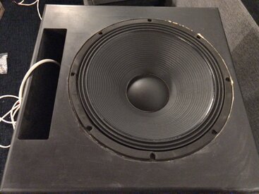

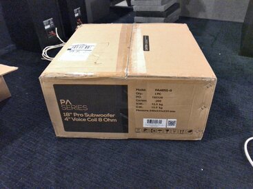

well this is really an after the fact as I built the enclosure a long while back and only got the driver a few weeks ago. I finally installed it for testing so I figure some pics are in order.

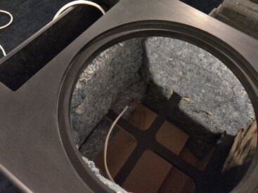

The enclosure is one of the DIYSG 5 cubic foot ported enclosures tuned to 19hz and cut for an 18" driver. This is typically used with a Dayton RS18HO sub, not a pro driver like I used. The pro drivers advantage is that it's motor is stronger, power handling higher, Xmax the same, and overall efficiency is much higher other than at the lowest frequencies. With a little EQ and room gain it will have a fine response in room. All the while using a lot less power under most circumstances and a bit lower distortion at the upper end of its response. I've wanted to do something like this for a while but didn't have time or room until now.
Before people ask, no I won't be doing 4 of these. I couldn't fit 4 of these.
The only thing I did out of the ordinary with the enclosure is I used a modern polymer adhesive that has visco-elastic properties but a very high bond strength. The front baffle is 2 layers of MDF adhered with this meaning it is well damped. This isn't usually important in a sub enclosure but damping is good to avoid problems with the wall resonances if the sub operates up into that range.
