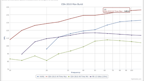

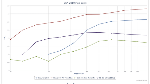

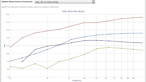

I’ll also mention that a single ultimax 15 in a large sealed box would give your PB a run for its money. It would have more output above 35hz by quite a bit. Below 35hz and above 15hz the PB would pull ahead because it’s ported design would allow greater efficiency and that 13” driver has a lot of displacement. Below that point the 15 would excel again simply due to being sealed and having a lot of displacement. If you put a single ultimax in that box and lengthened the ports to get a tune down to 15hz (I suspect more work than it’s worth) I believe it would exceed your PB13 at all frequencies. It would have a box volume and displacement advantage.
That gives you a sense of what I mean. That is the ultimax 18 vs the PB13. The 18 is about 3-4db louder than the 15 on average so it gives you a good estimate.
Now if you stick with pro drivers and leave it tuned as is, I don’t have graphs handy to show that. But a good estimate would look somewhere between this JBL 18 (which is tuned lower at 27hz) and this JTR Growler (which has a 12 in a horn but is tuned to 40hz and is similar in output to what we are talking about for you).
If you go with Two 15” pro drivers you would have more output than this growler I believe. Especially below 40hz where you would still have a displacement advantage before exceeding xmax. Keep in mind how massive these differences are. You get 6dB more output for each powered sub you add (so additional driver and double the power, 3dB for each). Basically you would need two of the PB13’s to equal what you would have at 40hz with a setup like this (or possibly 4 depending on what 15’s and amps you used with that box). You would need 4-8 of the PB13’s to equal what you achieve at 50hz to 100hz. That’s where the “kick” of the kick drum lies so think about that.

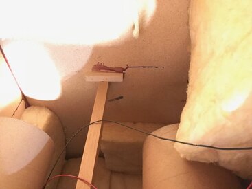

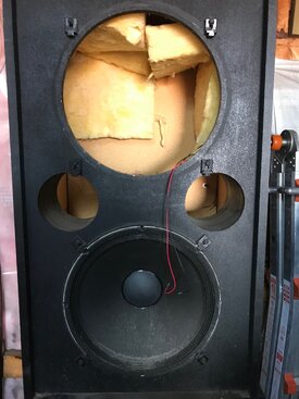

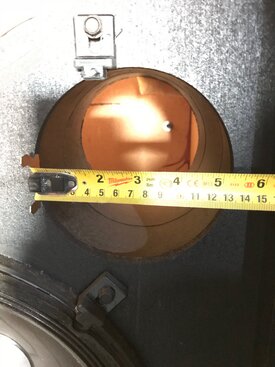

Ok, so here are some pictures of the inside of the box with the top driver removed. Looking at options to either extend the ports or turn this into a sealed enclosure

They are 8" in length
Ok Tony thank you.
I will show you some sealed options next, but...I did run some models.
Basically, you need to find a 90 degree elbow that fits over what looks to be a 5.25" port internally. I'm guessings its about 5.5" externally. I bet PVC won't work, but it could be worth a shot. You never know. It's possible that 6" PVC could be made to work. None the less, the problem you have is that the box is not deep enough internally for a sufficiently long port. My simulation suggests their claimed 40hz tuning is probably not quite right (though that might have been the f3 of the box). It appears to be tuned closer to 35hz (assuming their 9 cubic foot internal volume is correct). I suggest lengthening the port. At a minimum, you need to add 8" of length, but preferably, about 14". Anywhere in between those is fine, it doesn't make a big difference and just extends the bass. It drops the tuning to between 20 and 25hz.

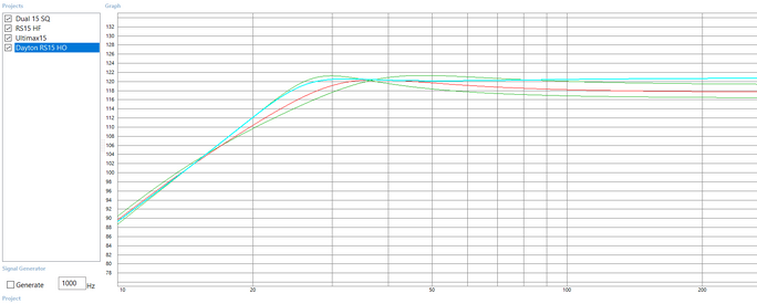

I know you can't tell which is which, but honestly, they all modeled pretty close in this box. The Classic is the one called Dual 15 SQ and its dark Green.
The ultimax is a similar dark green and it's the one with the blip in the response at tuning. So I will say, it's my least favorite. In a 9 cubic foot box, it really needs a lower tuning, and I don't think you have the room. If I was going to do the ultimax, I would do sealed I think.
I'll work on some models for sealed as well as some pro drivers to show those options.
These subs are all modeling between 120 and 124dB's max output between 25hz and 100hz. They are still doing over 110dB at 20hz. The Dual 15 Dayton RS HO has the most output ability (124 dB max, 114dB at 20hz. Over 100dB at 15Hz.
If you wanted to tune them to 15hz (you mentioned that earlier I think) the ports would each need to be extended by 45 inches. It isn't possible, so I wouldn't try. Also note, my simulations suggest that those big ports are actually a bit small for this project. They will chuff at max output. Tuning the lower will help, but I'm showing broad/wide chuffing starting at 50hz. Regardless of woofer, it seems like the system is port limited to about 600-800 watts.

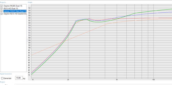

Now to give you a few more options to consider. Now I wanted to provide you with more options. Most are ported since XMAX dominates the low-frequency output, these are all very similar. The Ultimax would be the highest XMAX driver, two of them in a 9 cubic foot sealed box actually does a little better than the others in sealed boxes, but the Reference is similar, within 3db's. To really see a significant increase in sub 25hz output requires moving to a $500 high xmax driver, and you would need 1000's of watts to achieve that output.
The first option to consider is to plug the ports and go with a sealed design. The same 15" reference HO drivers are the orange line. The red line is the same drivers, same volume box, tuned to 25hz. Here is my warning, while the sealed box looks like way less output if you have a good amount of room gain, the sealed may actually have the flatter response. It will have lower group delay, and by 18hz the sealed sub will have more output. If you really want the sub-20hz extension, that is the design to build, and its pretty foolproof. You can always build the ported 25hz model and the sealed can be an option, just like with the SVS you have.
THe Blue line is the Dayton PA385 pro driver with 11mm of linear excursion. It's $199 a driver, so about the same price. A pair of those in the same 9 cubic foot box and tuned to 25hz gives you similar performance below 40hz, but above that point the PA385 has more output. In fact there is a 4dB output difference at 100hz, and in practice, you will find the pro driver can handle even more power and will have less power compression due to tt's design as a pro driver. That is insane output anyway, but worth mentioning.
The green line is a LaVoce pro driver. I mention it because its an inexpensive pro driver that might be available in Canada or at a discount. It won't be any cheaper than the Dayton, but it's an Italian designed driver from a good newer company. It's a nice driver.
