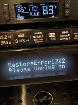

It appears my AVR attempted too auto update the firmware release today and now seems bricked...:rant::hissyfit: I have unplugged it and let it sit and then turned it back on and it’s locked up like this...can’t use it.

The power button currently does nothing...like I was surprised that the display was on when I went in the room.
the power button will not turn it off or on.
I can only unplug the unit.
I will have to try and contact denon support. Do not see that going smooth with the way things are going....

When you do either of these the AVR powers on and begins trying to update but then errors out. I plugged the Ethernet cable into my laptop and downloaded and installed 9 windows updates no problem so it’s not an internet issue.

Just got through too denon. They had me do a factory firmware restore ( press setup/dimmer/power until firmware restore shows on display) Which is working. If that didn’t work they would have me do a full reset on it. The firmware restore is almost done. Completed but screen went right back to the 1202 error....
