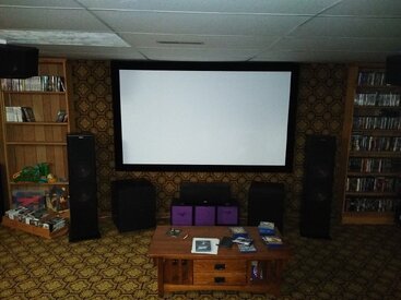

Thanks for the response Sonnie. This is what I had assumed. The clock radio comment was only meant as an attention grabber. I have an odd sense of humor. By the way I am envious of the subwoofers you have. Have you created any water leaks in your home from the vibration created? I had a solder connection start to leak shortly after I installed my first 15 inch sub. I cant imagine what kind of SPL you can produce. IMG_20201008_193107404.jpg
5,255
AVA Cinema
I had 8 x 18" subs in that same room with 10,000+ watts pushing them... crazy loud. Cloverfield shook the entire foundation of the house, but fortunately we've not noticed any damage thus far. The concrete sub-floor it is on is not on the same level of the house, so it's not directly connected, but the house frame and roof structure is all connected.
It's not all that loud right now with all that I have in the room. I mean it's loud, but not designed really to be super loud... it's more about clean now that anything else.
Nice setup you have. :T
