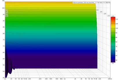

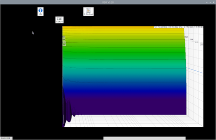

I installed OpenGL on Raspbian with the command
sudo apt-get install mesa-utils
tested to verify operation
but REW behaves strangely, it continues to have an almost totally dark representation but the waterfall works without errors but the presentation is almost all black.
I attach the photos
thank you

7,449
I guess that the Java runtime isn't entirely happy with the OpenGL implementation. Worth checking (or attaching) the log files folder in case there are any related error messages.

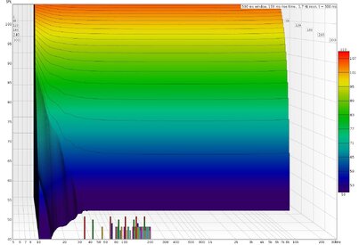

Feb 8, 2018
279
Italy
In the 32-bit version of the Raspbian operating system, despite not having OpenQL enabled, everything works correctly.
In this version I installed the java virtual machine 1.8.241 without activating OpenGL and in REW 5.20 RC6 the waterfall works correctly.

7,449
The installation error was caused by trying to install a headless runtime, no display and no audio in that. Good to see the 32-bit runtime works.
