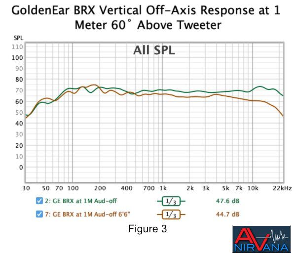

My limited test setup consists of REW used with a MacBook Pro and a MiniDSP UMIK-2 microphone. Of course, the other component of my test setup is MY ROOM. So, now in full disclosure mode, these are measurements performed in my less-than-perfect room and within the limitations of my modest test equipment. These measurements are not meant to supplant or contest the measurements given by the manufacturer. Instead, these measurements offer a comparison point from a real-world environment.
I started with the UMIK-2 at one meter, directly on-axis with the tweeter. (See Figure 1 below). All 1-meter testing was done with Audyssey off, the BRX running full range and no subwoofers. Only the left speaker was used for the 1-meter testing. One trace is with no smoothing applied, while the second trace is 1:3 smoothing. As shown in Figure 1, the curve is flat from about 90Hz to beyond 20kHz, where my equipment limitations kick in.
There is substantial bass energy down to 40Hz (about 10dB down from 100Hz), where it starts to taper off smoothly. GoldenEar states the frequency response of the BRX as 40Hz to 35kHz with no ± given. While I can't verify the claims beyond the 22kHz mark, there is a clear indication that the response carries on beyond the limitations of my equipment.
I also tested horizontal off-axis response at one meter (see Figure 2 below).
The horizontal response fell smoothly as I moved the microphone from directly on-axis with the tweeter to 15˚, 30˚, 60˚, and entirely to the side of the cabinet at 90˚.
I tested vertical axis response (See Figure 3 – below) by elevating the UMIK-2 to 6.5' and maintaining the 1-meter distancing. This placement gave me about a 60˚ angle at one meter above the tweeter. Response smoothly fell across the board, confirming the radiation pattern commonly attributed to this type of tweeter, broader in the horizontal, narrower in the vertical.
full
Doing a walkabout confirmed that the high frequencies dropped off smoothly as the angle diverged from the tweeter center axis, but the speakers continued to sound natural at all but the most extreme angles.
