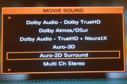

Although my processor allows me to select Auro 3D as an option when it sees Dolby Atmos or other Dolby surround modes when it sees DTS:X on a Blu-ray it limits my choices to other DTS options and Auro 3D is not included in those options. The only work around I have found is if I select PCM in my Blu-ray player instead of bitstream the processor will not select DTS:X but will allow other DTS options along with Auro 3D. But that is a hassle and not worth doing.
Perhaps if you have contact with Marantz you can suggest a firmware update allowing their processor to include Auro 3D as an option when it sees DTS:X.

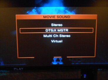

This time it's not Dolby being restrictive. The limitation only happens when DTS:X is in the mix. When Dolby Atmos or DTS Master HD is on the disc all surround modes are available. I am including screen shots of available surround modes when DTS:X is present and the surround modes available when Dolby Atmos or DTS Master HD is present.

9,317

I wonder if this DTS:X restriction is only on Marantz processors. Perhaps if you still have access to the Trinnov processor you can play a DTS:X disc and see what other surround options are available on the Trinnov. It would be nice to know what you find out.

It might be… I’m away from my desk, so to speak, I’ll check on my Storm processor when I get back

So, the answer is 'yes,' when a DTS:X film is playing, the Storm processor allows you to upmix to Dolby Surround and Auro. So, you're likely looking at an arrangement that's held exclusive to Marantz/Denon gear. Who knows what the licensing agreement says, but that's gotta be the restriction. I can't imagine a scenario where your AVR is limited by processing overhead.
