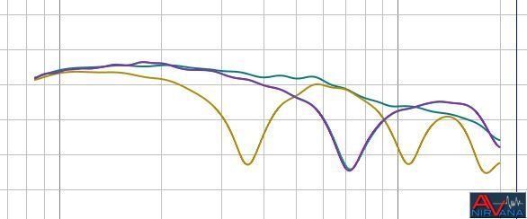

Hello,
I get different results on the same measurements in REW.
In the picture you can see three graphs. These measurements are all taken with the same level calibration and the same settings. The MIC and speaker stayed at exactly the same place. All the measurements are gated with a 3 ms IR Window.

Are you using multiple sweeps? Need to use single sweeps with a USB mic (or more generally when the input and output are on separate devices).

Yes I indeed use multiple sweeps (I thought that would give a better result)
I will test what happens when I use single sweeps, great TIP.

Ok I can confirm this was the problem. Now if I takes measurements in one sweep, the curve stays almost the same, but not identical.
One little extra question, because I use a USB MIC and sound card, I can't calibrate those two in REW. I assume this is not a problem because the MIC is calibrated by file. But still, the sound card is not. Am I missing a step here, or is this just the way it works?
