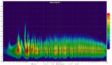

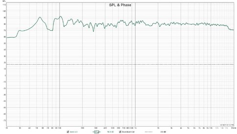

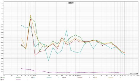

Dear all, these are my first measurements taken today in my music listening room.
I'm fairly surprised how well they (at least) look in terms of flatness of the curve. I thought my starting point was worst than this honestly.
I know that I need to treat in some way, to improve RT60... but need to consider this is not a dedicated room.
Apart from measuring, while listening, I know my room suffers one main defect that gets evident in rock/prog music: when big dist guitars or drums cymbal kicks in, the sound gets really messy and unpleasant.
Can anyone 'see' this awful behavior in my measurements and advice how to try to correct?
In general, how would you approach correcting this room?

You response doesn't look that bad overall. It looks a bit flat and likely sounds about the same. Most will prefer a tilted response with 5-15dB more bass from 80-100Hz on down.
There is some question as to what you measure at the listening position being what you actually hear, since the measurements will include reflections. If you have access to the anechoic measurements of your speakers, you can get a starting point as to what you should be hearing. Otherwise, the best you can do is fix the lower end, since it will measure fairly true to what you are hearing. You can fix most of the low-end with EQ fairly easy. Not sure what your HK AVR has EQ wise, but a miniDSP with PEQ filters is very reasonable.

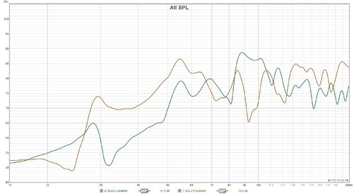

As you see the L speaker is giving the worst contribution to the bass section... does it mean that it all has to do with placement and not with anechoic response?

Are those reds in the very low end of the spectrogram room modes?

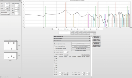

This is the room simulator run for my current room. As you see, I'm forced to not simmetrical speaker placement.

You could certainly try some panels to deal with any serious reflections you have ... some use absorption and some use diffusion. As for the lower bass area, that is harder to deal with using panels and electronic EQ may work better in most cases.
Placement indeed will affect the response, which is something you could experiment with, but in most cases you want to start with the placement that gives you the best soundstage and imaging, then try to deal with the response from there. Having the anechoic response off-axis can help you determine what the room is doing to your response.

Your listening room seems to be quite "live". If the volume of the room is 100 cubic meters, then the optimum RT60 is 0.25 s, at 50 m³ it is 0.2 s approx. The electrical correction doesn't solve the problem, as it is valid for only one point in the room. Further, if the loudspeaker response is flat under anechoic condition (a reference), then in the a semireverberant room certain lift in the bass region usually appears because of the underdamping there, which is normal and well accepted generally.

Looking at your RT60 graph, you might have what Mr. Linkwitz would have called a "lively room" = highly reflective = more complex music passages might be lost in a high % of reflected music??
See his info at linkwitzlab.com/rooms.htm
sections D5 & D6
As Sonnie has said "you could certainly try some panels" which would also lower your RT60 average.
As always, the bass region will be mre of a challenge, but it will be very helpful on the clarity, % of direct sound vs % of reflective.
Using the ETC graph of your rom can help with placement since a before and after measurement will allow you to see if you have dampened the primary reflections.
see info at gikacoustics.com/unpacking-etc-time-domain-measurements-early-reflections/
Lowered down there is asection called "smooth spikes" and they explain how the delayed reflection spikes can help you identify where the reflective spike comes from and if you hit the mark with placement of absortion panels, they "after" measurement will lower these spikes (as measured from your listening position, the one that matters most).

I'd suggest the upper midrange is too hot. While the SPL plot is absurdly scaled, it seems the 600 - 1k3 Hz range is about 5 dB louder than the flanking bands. This usually sounds like a thin midrange and nasty presence range.
RT60 and Spectrogram with same tendency hint at the room, but +5 dB due to room characteristics would be extreme.
Is the SPL measurement done with one or all speakers active?
Yes, please change your scale from 10dB to 5dB.
Alternatively, I'd suggest a low-Q filter (~0.5?) to raise the 200-600 range.
Can't remember but I believe two,
as the picture in the following post has the L and R speakers plotted separately.
One of my doubts: I understand one speaker measurements help you understand better what you need to treat, but then you switch both speaker on and need to treat the treatment...
So, why not to treat the sum of the L+R contributions?
