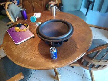

I just built a ported box using the Ultimax 15, and I am very impressed with it. I am only running a 500 watt Dayton amp. That will get upgraded someday. Looking forward to changing out my Cerwin Vega 15 when it craps out.
